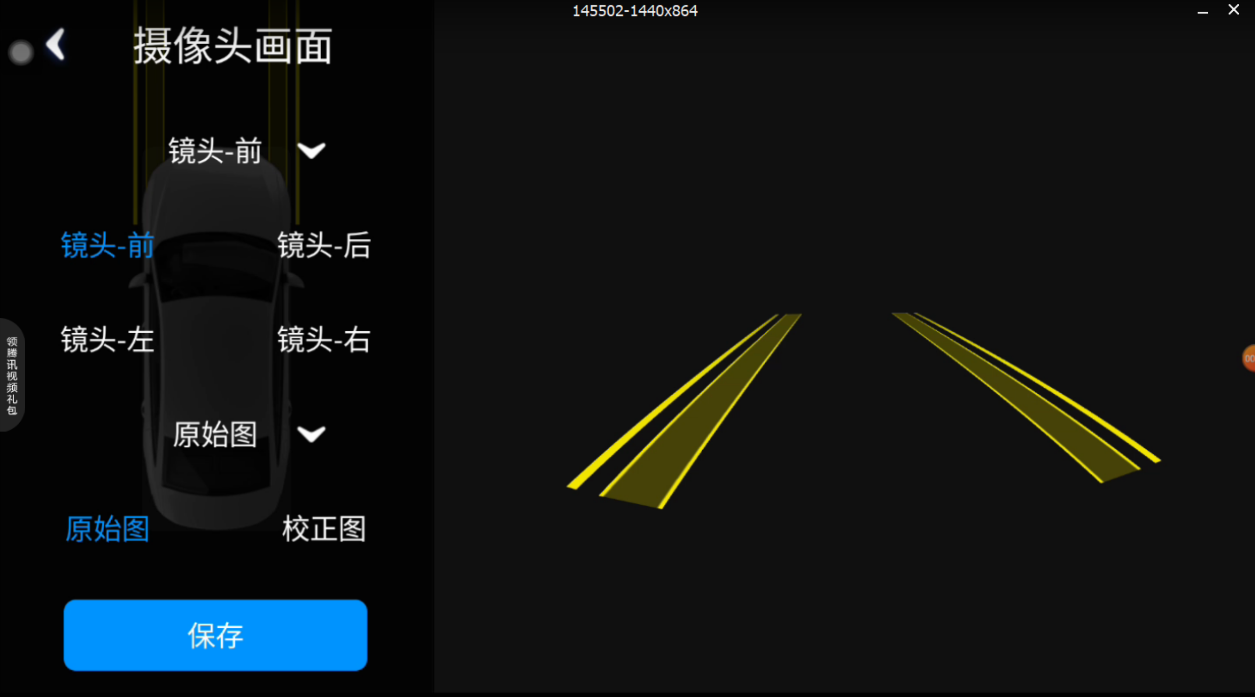

Image 1 | A user-owned four-camera engineering interface. It shows a software screen with four camera inputs; it is not the board in this document or an overseas installation test.
