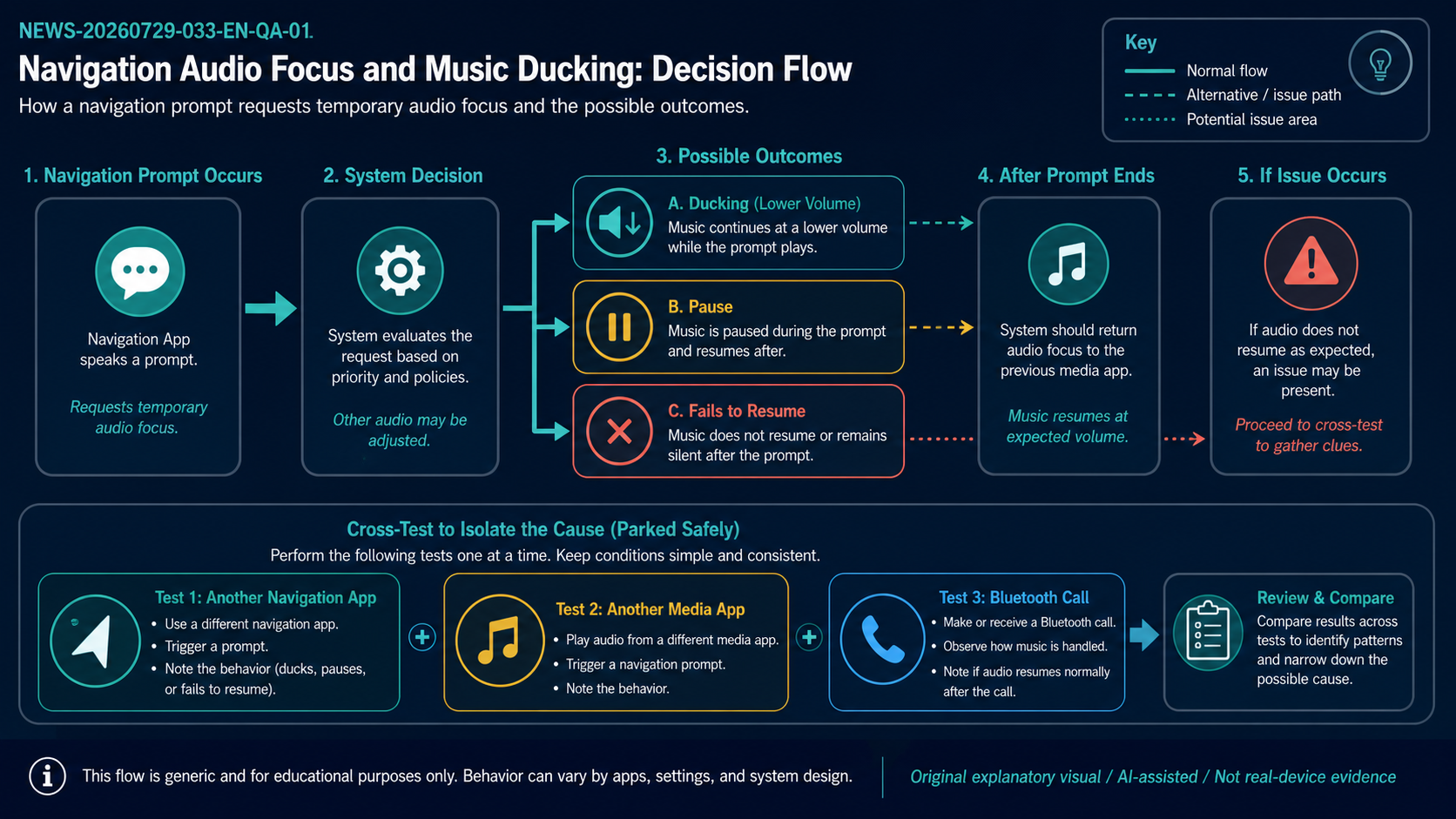

Check guidance, ducking and resume settings, then cross-test with another navigation and music app.
Figure 1. Navigation audio-focus and music-ducking decision flow. Original explanatory visual / AI-assisted / Not real-device evidence.

Android audio focus (Android’s rule for deciding which app gets to speak) supports temporary focus changes and “ducking,” where background audio continues at a lower level during a navigation prompt.
Spoken-word apps may choose to pause instead of ducking.
Labels such as Smart, Third-party priority, System priority, Mix or Exclusive are vendor-specific policies.
Their behaviour is not portable between head units, and third-party navigation or media apps may respond differently to focus requests.
While parked, test three combinations: music with navigation, a podcast with navigation, and music with a Bluetooth call.
Record whether the background lowers, pauses, continues unchanged or disappears.
Adjust the mix only after identifying the actual behaviour.
