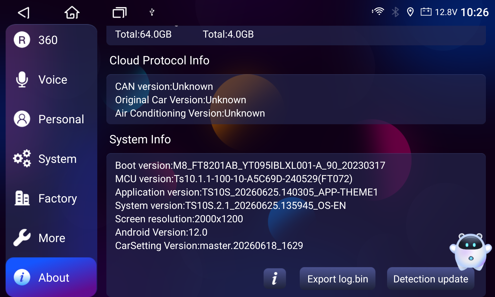

Start with the current version
The starting system version was TS10S.2.1_20260625.135945_OS-EN. Keeping this page alongside the post-update page makes the change easy to see.
The version page before the update.

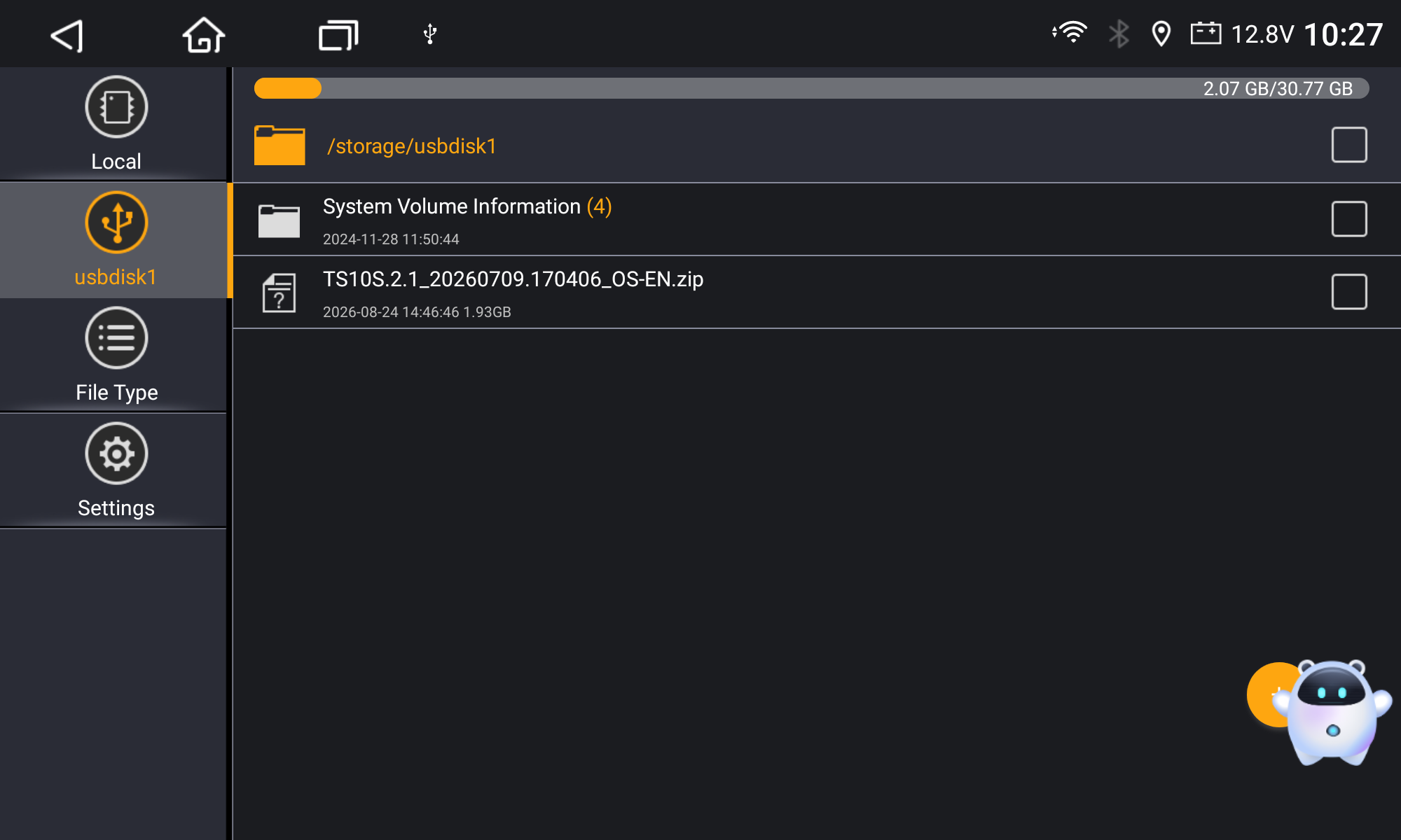

Find the package on the USB drive
The file browser showed TS10S.2.1_20260709.170406_OS-EN.zip in /storage/usbdisk1. It displayed 1.93GB; the recorded package size is 2,067,308,403 bytes.
The target ZIP in the USB drive's file list.

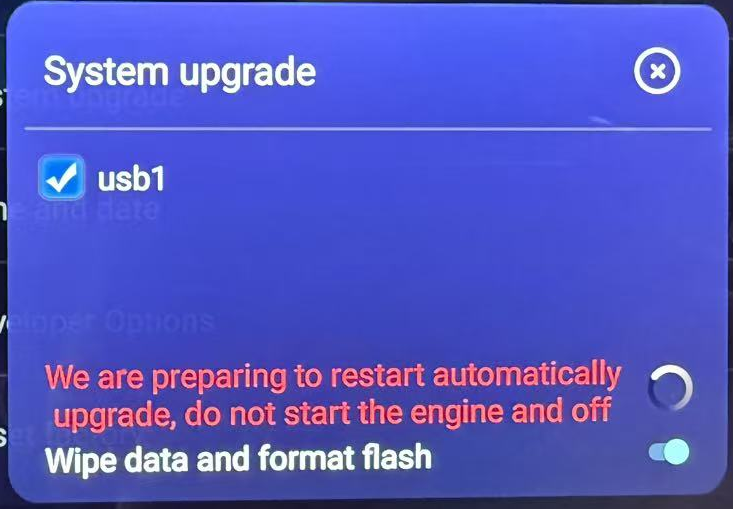

Open System upgrade
The unit's System upgrade screen had usb1 selected and displayed the restart-to-upgrade prompt. A Wipe data and format flash switch is also visible. The return does not document a backup or which wipe setting was used; follow the instructions for your exact unit rather than copying that switch from a photo.
The System upgrade prompt with usb1 selected.

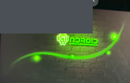

Let the update run
The next photo shows the system-update screen. Keep power connected during the update, as the upgrade warning instructs. After the process, the unit returned to a version page showing the new system build.
The unit during the system update.

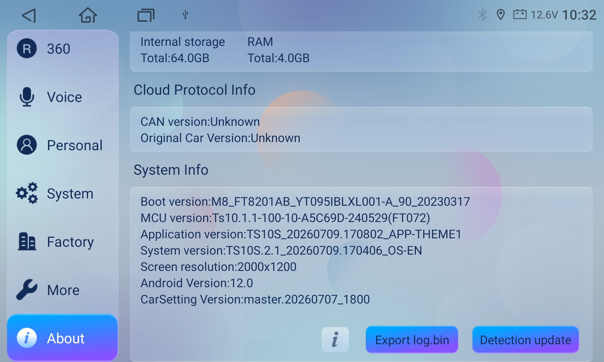

What changed on the version page?
The system, application and CarSetting builds changed. The MCU, Boot and Android strings stayed the same.
ItemBeforeAfter
SystemTS10S.2.1_20260625.135945_OS-ENTS10S.2.1_20260709.170406_OS-EN
ApplicationTS10S_20260625.140305_APP-THEME1TS10S_20260709.170802_APP-THEME1
CarSettingmaster.20260618_1629master.20260707_1800
MCUTs10.1.1-100-10-A5C69D-240529(FT072)Ts10.1.1-100-10-A5C69D-240529(FT072)
BootM8_FT8201AB_YT095IBLXL001-A_90_20230317M8_FT8201AB_YT095IBLXL001-A_90_20230317
Android12.012.0
The post-update version page, with the new system and application builds.

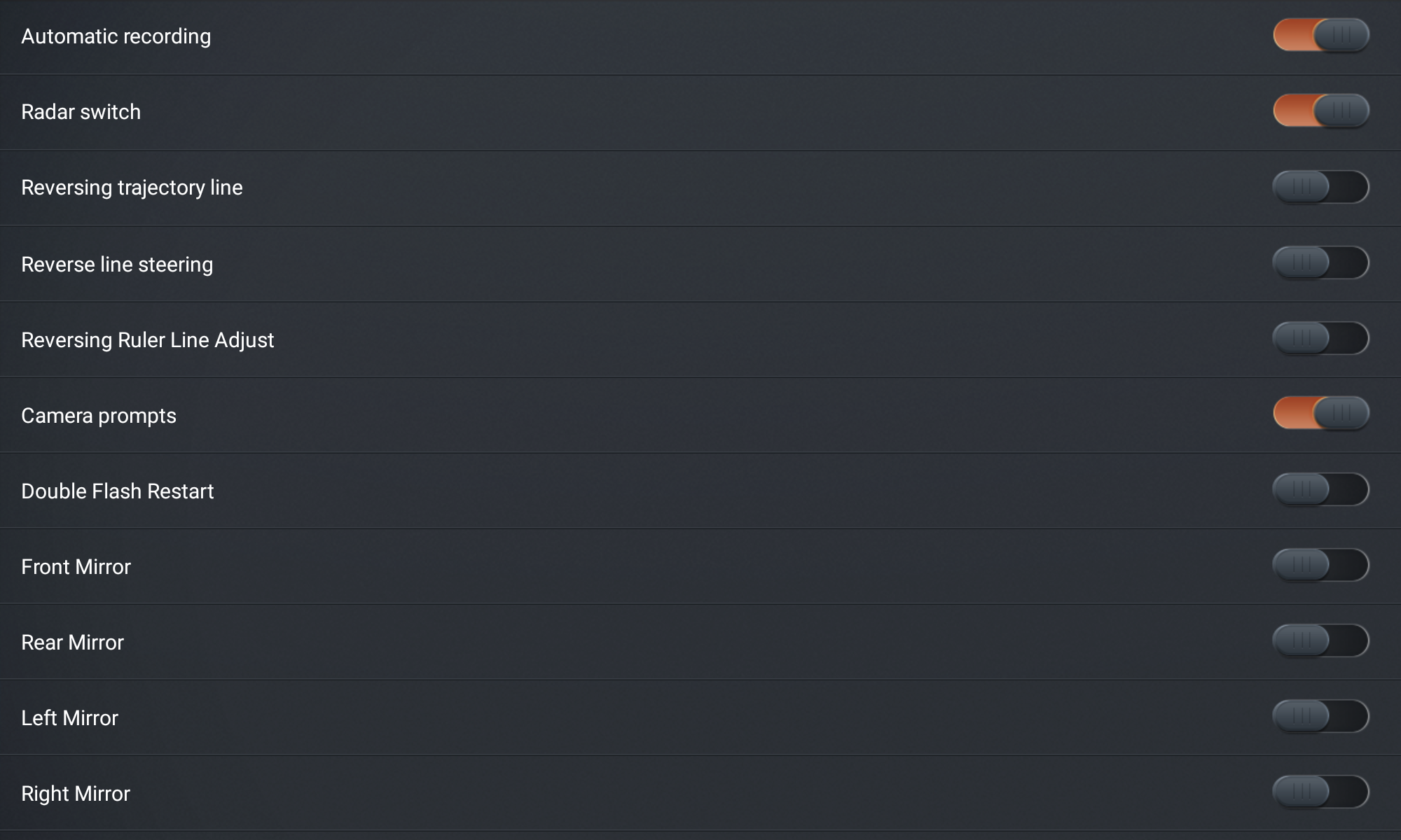

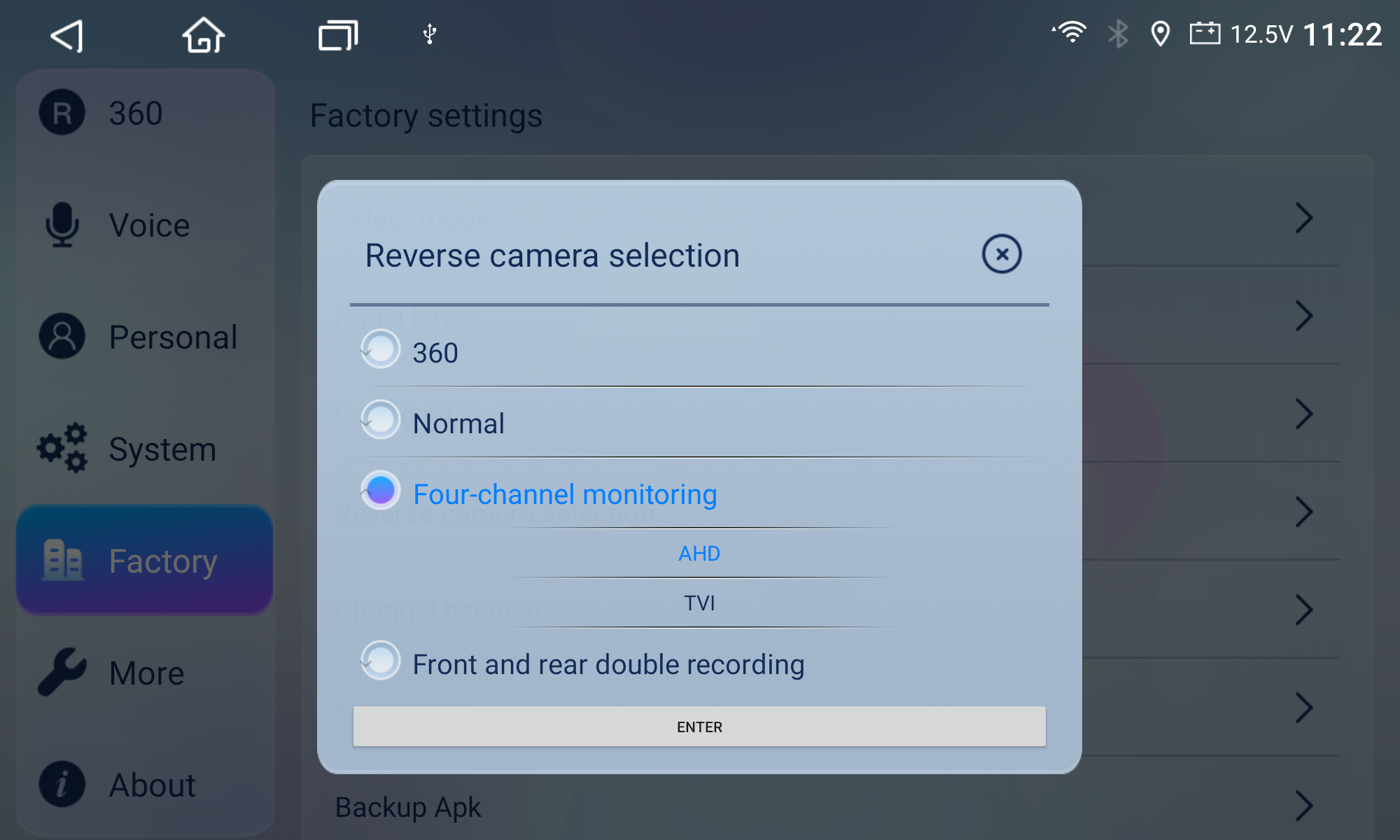

The camera menu includes Four-channel monitoring with AHD selected. The tester reported that after choosing this mode and the automatic restart, Car Settings reported an error and crashed. No photo of that error was retained.
Four-channel monitoring and AHD in the camera menu; this is not a photo of the reported crash.
A separate screen shows Front Mirror, Rear Mirror, Left Mirror and Right Mirror controls. It shows where those settings are; there are no four-camera output comparisons here to demonstrate their results.
Separate front, rear, left and right mirror controls.
